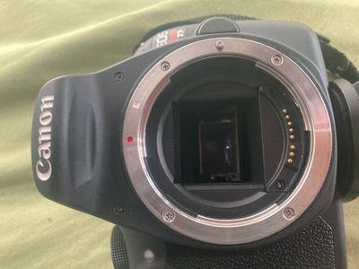

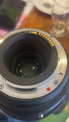

Hello everybody,
does anyone ever tried to mount a Sigma 150-600mm F5-6.3 DG OS HSM on a Rebel T5 camera ?
regardless to the lense specification, it should work with EF mount, but I didn’t succeed. I had to force a bit, but even with that it wasn’t possible. Then I stop to not damage my equipment.
thanks a lot 🙏

06-02-2024 07:12 PM
Ok thanks you.
That’s so strange then. I guess it’s better not to force in any case. Should enter easily, maybe i am doing something wrong.
But I still have an interrogation. Is that normal that the lense and my camera don’t have the same number of little points for the connection?

Okay, I think I was doing it properly but gonna try one more time.
I was also speaking about this number that is not the same on the body and on that Sigma lens. Is that something strange or doesn’t it matter??

06-02-2024 09:35 PM - edited 06-02-2024 09:38 PM
Lenses with longer FL and some macros have 3 additional contacts for communication. Your mount looks correct Canon EF. The head of the screw closets to the red alignment mark appears scored. It might be that someone just tightened the screw holding the bayonet with the wrong type of screwdriver, or something has been disassembled.
So next question. Where did you buy this lens?
~R5 C (1.0.6.1) ~RF Trinity, ~RF 100 Macro, ~RF 100~400, ~RF 100~500, +RF 1.4x TC, +Canon Control Ring, BG-R10, 430EX III-RT ~DxO PhotoLab Elite ~DaVinci Resolve ~Windows11 Pro ~ImageClass MF644Cdw/MF656Cdw ~Pixel 8
~CarePaks Are Worth It
06-02-2024 10:01 PM
Hi Gaetan and welcome to the forum:
Is this lens second-hand but new to you?
Looking at the image that you included, I am concentrating on the screws towards the bottom of the screen. It might be lens distortion from the image itself, but the bottom left screw looks like it is not fully down, and the one on the lower right, just past the red dot, definitely seems to be burred or worn . Finally, the engagement lug (the hole to the right or above it again), looks to have some sign of wear - it seems to be showing a gold reflection, but that might be a play of light.
My temptation is to suggest that if this is a second-hand lens, it has been played with by someone who is not a trained technician and has possibly removed the mount and not put it back properly. Sigma does have a service where one can have a mount switched, say from Nikon to Canon or Sigma, but they would never leave the mount with burred screws.
