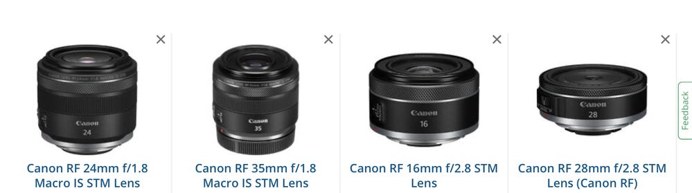

Waddizzle
Be aware that all video features might not be available with the third party lens.  There are numerous Canon EF mount lenses, mostly older lenses, that are not compatible with all the advanced video features that are available from Dual Pixel AF image sensors.
Specifically, Movie Servo AF may not be available.  If it is available, then it could function in a degraded mode.  I suggest that you download a copy of the User Guide and read the sections about how to film video and using Movie Servo AF.
Be aware that you would also need to purchase a mount adapter to use the lens on an R Series camera body.  I recommend investing in one of the Canon wide angle primes and video lighting.
