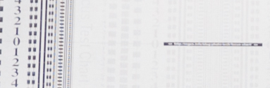

I have a 24-70mm f/2.8L lens and am finding that it is not as sharp as i'd expect.  I'm sure it's me and not the lens so hoping someone can help me understand what i'm doing or not doing correctly.
I'm attaching a picture as an example...hand held...here are the settings:
EF24-70mm f/2.8L II USM
59.0mm
1/640 sec;   f/2.8;   ISO 400
Shutter priority;   Spot metering
shot with 70D
when you zoom into the tree it is cleary not in focus/sharp ;(
I've tried at differen shutter speeds but still having the same issue... going to try different apertures next...

just retook using 1/3200, f/2.8, ISO 100... image is darker but still not in focus...this is using the t1i...

redid using ISO 100, f/4 and 1/1600th sec and there is no difference... pics look almost identical....  shot in raw and then cropped in PS CS6...

results look worse (i think) on the 70d @ ISO 100, 41mm, 1/1600, f/4  ;( i don't know what is going on ;(
i can't open the 70d in RAW in PS CS6 - don't have the new plug in for that camera - so using the jpg for this one/camera...

Using the exposure rules that Tim provided and a tripod are you getting a focus confirmation from each camera?
You are focusing right on the printed mark in "one shot"? Not any tracking AF ? Just the center focus point selected in the camera? All camera defaults set to factory?

when i hand take the shot i see the confirmation (ie it beeps and is red) - to be honest not sure if it is when using remote - ie i don't recall if i heard the beep..... i'm assuming i should even with a remote? right?  and yes it is on one shot and the center AF is used.... i didn't change anything on the 70d so should be at factory defaults but will check or at least reset to factory defaults.  I've had the T1i for a long time but do not recall changing any settings that may impact the shot but will reset to factory defaults too .... too dark now to redo with natural light so will have to try again tomorrow....
i'm also going to re take the shots using my kit 18-55mm that came with the T1i and my sigma to see what the heck is going on - ie is it only that one lens or all - if all then it's an camera issue - i'd think.... but can someone confirm if that test sheet is a good test for any lens at about 10 feet set to largest aperture?  if anything at least it will test if focus is bang on or not right?  will try using ISO 100, f/4, 1/1600 if light permits... will recheck Tim's list ot ensure those are the correct corresponding values...

You must have focus confirmation one way or another.
The sample shots you posted are, frankly, horrible. It looks like the lens never focused at all, in the first place.
It sounds like you are doing everything correctly. But not actually being there I can not 100% confirm it.
I am having a hard time believing a Canon 24-70mm f2.8 L lens is faulty. It is assembled by the top, best, technicians Canon has. Each one is individually inspected and tested by the best. But as the saying goes, "Anything made by the hand of man can and will fail."

i just took some more shots....what i'm finding is that at 5 feet or less the lens is sharp... then when i move to 10 feet it starts to not be in focus ..... at 10 feet i'm using a tripod and a remote....
having said that at 5 feet or less that center text is ALMOST there - meaning it's still a tiny bit off... but the numbers down the side are in focus perfectly.... that is at f2.8... i had to use 1/200 and ISO of 200 or 400 ... but that is more becuase of lighting - i just do not have a spot in doors that is bright enough to go to ISO 100 and i can't go outside - it's way too cold ;(
i know all lenses have a workable distance - that they should be used for - how to i confirm what that distance is for this lens?

"i know all lenses have a workable distance - that they should be used for - how to i confirm what that distance is for this lens?"
Maria you are beginning to lose me here?  What do you mean?  That lens should be crystal sharp at all distances from min focus to infinity.
Do one last thing for me. Switch off auto focus. Set the camera on the tripod. Manually focus while you are looking through the view finder. Focus on the test spot and do some shots. If it looks to be in focus in the viewfinder it should be in focus period. Use the screen (CRT), not a printer, to view the result.
At this point you don't know anything. Whether the lens is good or the camera is bad or whatever else.
I am banking on the lens being fine.
