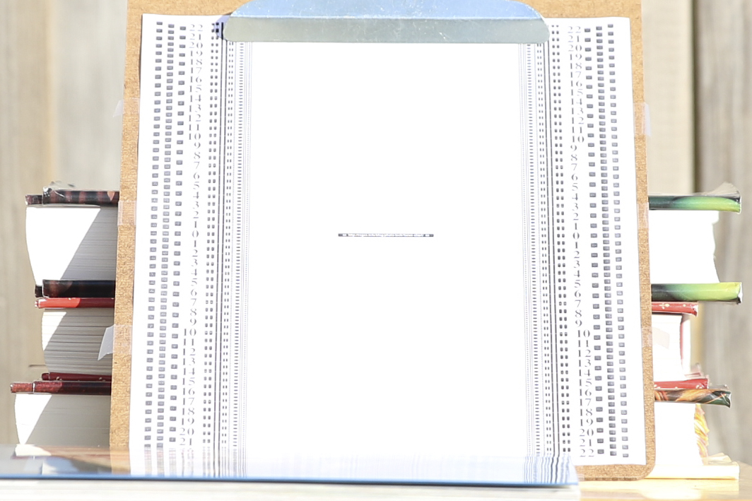

I have a 24-70mm f/2.8L lens and am finding that it is not as sharp as i'd expect. I'm sure it's me and not the lens so hoping someone can help me understand what i'm doing or not doing correctly.
I'm attaching a picture as an example...hand held...here are the settings:
EF24-70mm f/2.8L II USM
59.0mm
1/640 sec; f/2.8; ISO 400
Shutter priority; Spot metering
shot with 70D
when you zoom into the tree it is cleary not in focus/sharp ;(
I've tried at differen shutter speeds but still having the same issue... going to try different apertures next...

redid the test using my T1i... at 1/1000 everything was blown out .... had to set to 1/4000 and ISO 400 to be able to see the test sheet .... it's nice a brigh outside.... when i looked at these shots i can say that they are slightly better than with the 70D but i stress slightly - almost not noticable difference.... on the T1i that center text is not in focus either and the numbers done either side of the chart are about the same result as the previous one (70d pic attached).... ;( ;( ;(
going to go back out and wait for the sun to be under some clouds then take again using the 70d at f/4 and see what happens.... anything else i should try???

just retook using 1/3200, f/2.8, ISO 100... image is darker but still not in focus...this is using the t1i...

redid using ISO 100, f/4 and 1/1600th sec and there is no difference... pics look almost identical.... shot in raw and then cropped in PS CS6...

results look worse (i think) on the 70d @ ISO 100, 41mm, 1/1600, f/4 ;( i don't know what is going on ;(
i can't open the 70d in RAW in PS CS6 - don't have the new plug in for that camera - so using the jpg for this one/camera...
