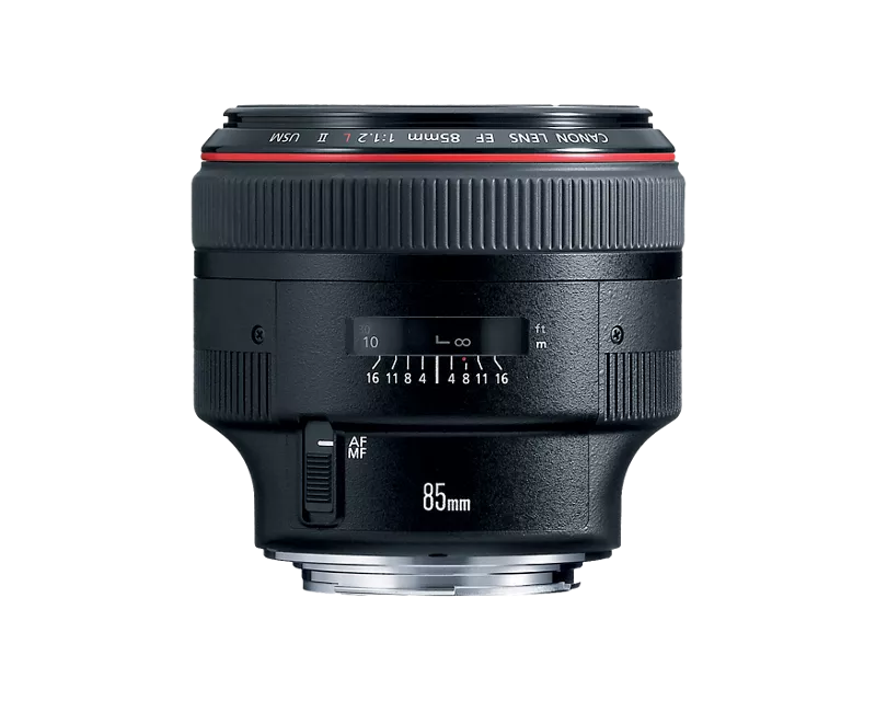

I recently picked up a used EF 85mm 1.2 L II to use primarily on my R6 mk2. I've found that it tends to focus somewhere other than where I point it. When I use Spot or 1-Point AF, it seems to be looking around to find maybe the closest object, or maybe the highest-contrast object rather than what I have the focus point aimed at. It doesn't matter how much light there is - this can be in broad daylight or in low light.
As an example, taking a picture of a plant pot - I put the AF mark on the leaf or bloom that I would like in-focus, but the camera focuses on another leaf or bloom. I've tried opening up the AF options to larger areas, and that just broadens where it looks... and rarely focuses on what I intend. My expectation with Spot or 1-Point AF is for the camera to focus on that spot each and every time, assuming there is adequate light, which there is.
I've tried two different adapter rings, and that doesn't make a difference. I've also tried the lens on my daughter's Rebel Ti, and it works better there. That camera only has a few focus points, and the lens focuses on the point I select each and every time. Could there be an issue with the lens, or maybe this EF lens just doesn't talk well to an RF camera's new focusing system? I can send the lens back and try another one, but I thought I'd check to see if this is a common issue for this lens (or camera settings?) before sending it back.

Thank you for the thoughtful replies. Several questions were asked, so let me try to clarify my "use case" to help narrow down what's happening. I'm in the back yard, aiming at and attempting to focus on individual objects to confirm operation. For these tests, I am not trying to make quick shots - I am being careful to not exceed the capability of the lens focus type/motor... this is non-moving, no-action shots of static objects like plants just because I have several to pick from as I walk around. In the "old days" with an SLR, I would be able to pick one particular leaf on a plant, focus (with back button) on that leaf, and then snap a picture.
Since reading and re-reading these replies, it did occur to me that I've blamed the lens when the issue may really be the camera or my expectations. I've confirmed that this morning while testing the same scenario with other lenses like the RF 28-105 F4 L and my old EF 70-200 F2.8 L. Both act the same unfortunately :-(.
A simple example that may help to explain my frustration is this: I'm standing on my lawn and aim the center focus point at grass that is 10' away, then 20' away, and then 30' away, pressing by BBF button each time. And each time, instead of focusing at the spot (or dance/plane) that I've selected, the camera picks another area of the lawn or maybe a fence in the distance (40-50' away). Do I have an unrealistic expectation of being able to focus within the plane that I've aimed the center focus point at?
