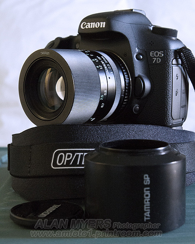

Here's photo of the 90mm macro lens with the EF/EOS mount installed and a Nikon mount alongside. I also have Adaptall mounts for vintage Canon FD, Olympus and Konica camera systems, so can use this lens on any of those.
To help you figure out if yours is also one of the Adaptall lenses... Notice the little turqoise dot on the lens, near the base? That's a registration mark for the mount itself, which bayonets onto the rear of the lens and is something you might look for to determine if yours is an Adaptall lens too. Another identifier for an Adaptall lens is a little chromed button on the side, that's a release for the mount bayonet. Pressing it and twisting the mount, it should come off the rear of the lens.
Here's the 90mm lens and mount on one of my Canon DSLRs...
