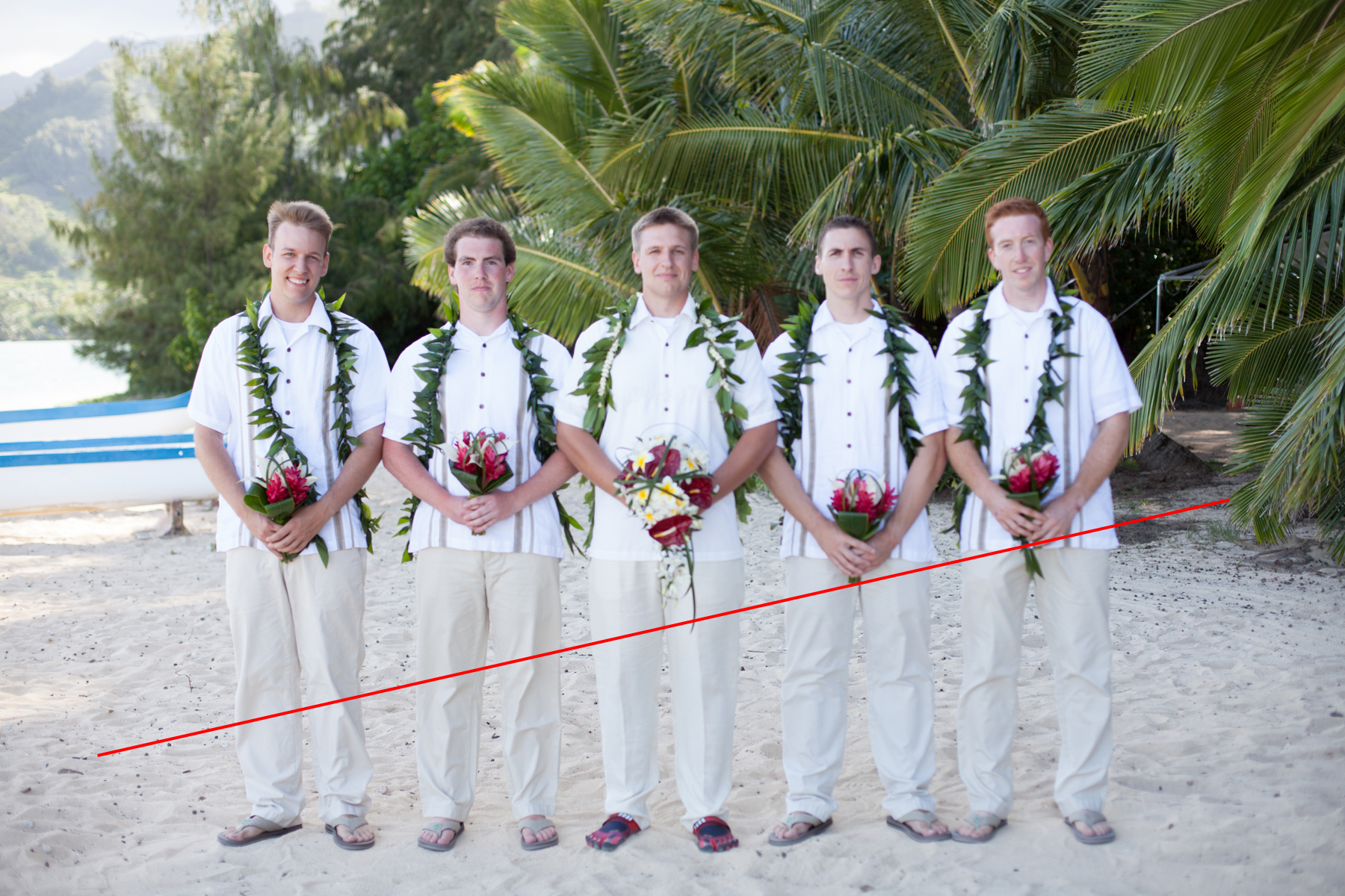

I've been having problems with my 5D Mk ii and my 50mm 1.4 lens, and I think it has to do more than just a front/back focusing problem. My 50 1.4 works amazing with my 5D Classic and I've never had any issues with it. Super sharp wide open. This photo below was shot at 2.5 and I had them all on the same focal plane (I think!?). Notice that the two guys on the left are fairly in focus and then 10-15 feet behind the guy on the right is also in focus. What the what!?
Anyone have any ideas on this? Is it user error? Also I uploaded the image at 1800px wide but if you can't see the full size I can post it somewhere else and link to it.

At this magnification I couldn't tell if the guys on the right is in focus or not. They look like they are in focus to me. If they are not, could it be everything is clear all the way to the trees behind the guys as far as DOF goes and any blurriness to any of the guys are due to the lens outer edges not being as sharp?
09-04-2013 02:25 AM
If you right-click the photo and hit "open image" or some variation of that you'll see a higher resolution image. I've attached another photo that shows what I think is the plane of focus in this particular shot. That can't be right! Right??? I'm pretty dang sure I wasn't that far from parallel with them.

It's possible that there's a problem with a lens element. This is basically how a tilt-shift lens works (they can angle the plane of focus so that it's not actually flat -- except a tilt shift lens lets you very precisely control the lens tilt.) But as you say the same lens works great on your 5D classic, I'm wondering if you're not experiencing a sensor shimming problem.
The sensor inside your camera is mounted on shims. They are adjustable... but only by service (a tremendous amount of disassembly is required to get to those sensor shims). It's possible your sensor is not technically perpendicular to the lens axis (e.g. part of the sensor is technically closer than another part). You'd have to send the camera in to Canon to have that serviced, but it would be well worth it as the 5D II is a fantastic camera.
