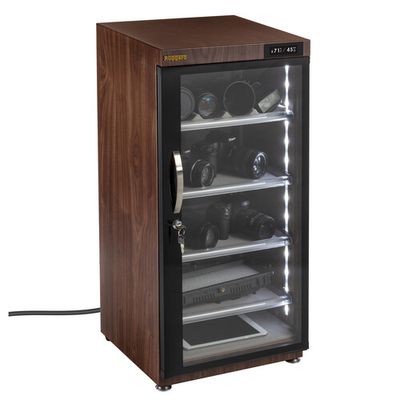

Specifically I have read about people storing their lenses in plastic bags with silica gel packs and some going as far as purchasing Ruggard  humidity controlled dry cabinets.

Over a year ago, maybe two, I purchased a Ruggard dry cabinet from B&H.  Maintains temperature and humidity at whatever level you set.
Everyone has their own methods and opinions on how to store their gear, but I have to say that the dry cabinet has been set and forget for me.
Mold and fungus can't grow in unfavorable conditions.  Dry cabinets are not affected by external environment.  There's no silica gel packs to mess with or anything you have to watch or remember to change.
It wasn't expensive and does exactly what I wanted.  Climate control works for a reason.  So my advice is do whatever works for you.
