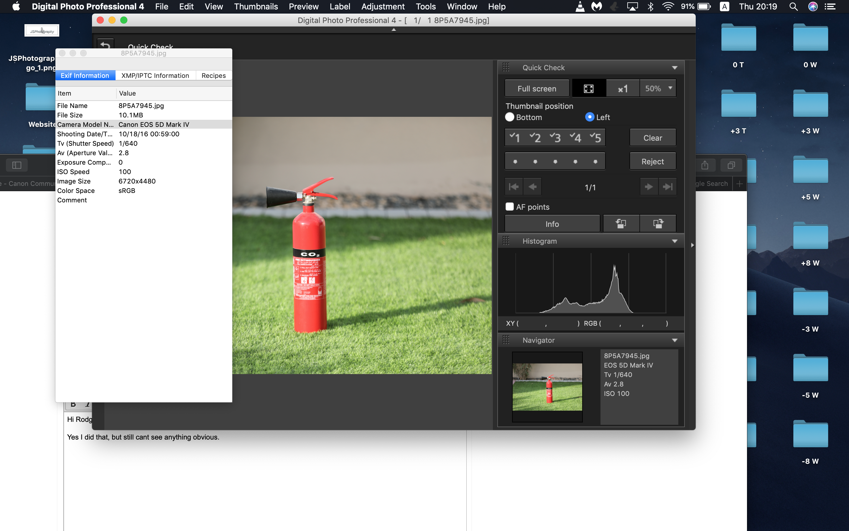

06-18-2020 12:20 PM
Hi Rodger,
Yes I did that, but still cant see anything obvious.(screenshot attached).
James

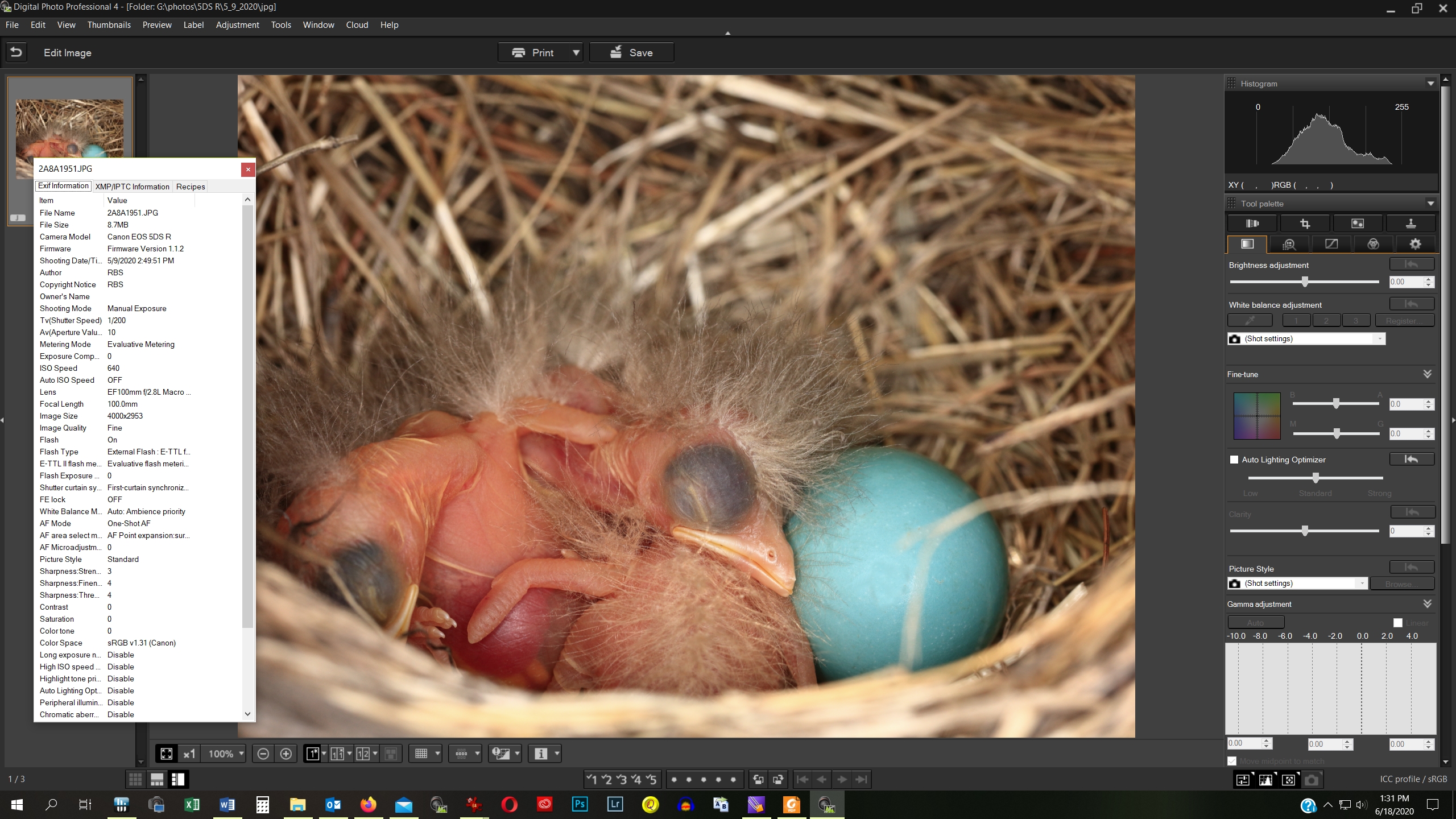

06-18-2020 02:37 PM - edited 06-18-2020 02:39 PM
Hi James,
I am not sure if DPP behaves differently on Apple but it seems like the EXIF data should still be there. Attached is a screenshot from my PC setup.
If it doesn't show up with the Mac version of DPP, you will need to keep track of it by shot (i.e. the first 3 were shot at 0, the next 3 at +3, etc.) however it is sure handy to be able to read it from the EXIF.
On Edit, you might try it with RAW instead (which is how I capture all of images, maybe you will get the full EXIF that way with the Mac version of DPP).
Rodger
