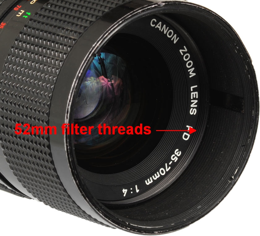

I've purchased an excellent condition Canon F1N off Ebay; and have bought several lenses for it. I think one lens may be a counterfeit (the lens does not have threads on it which will accept a 55mm filter). Where do I go to verify the authenicity of my gear? Thanx. M

The FD 35-70mm f/4 uses 52mm filter threads.  The filter threads are not at the very front of the lens.
The filter threads and front element move around inside the front outer lens barrel. To put on a filter, you have to zoom to 35mm and focus to 0.5m to get the front part of the lens to come forward enough to reach the threads.
The original lens cap is a rubbery plastic Canon cap that fit fairly snugly over the outer lens barrel.
Here are two photos: One without a filter and one with a 52mm filter installed.

I don't believe anyone has ever made counterfeit lenses. Especially when it comes to older Canon FD lenses.
Are you saying your lens has no filter threads at all?   Which lens is it?

two weeks ago, I bought a canon fd 35-70mm f4.0 off Ebay. I only buy from sellers with a 100% rating. I needed a 55mm skylight filter to protect the lens.; got the filter, tried to screw it in... and nothing.. in fact 55mm, a standard size, was a bit too small. taking a good look at the threads on the lens... there weren't any. just concentric circles which LOOK like threads until you get about 4 inches away with a bright light. everything elsa about the lens looks like the real thing. it weighs what my other fd's weigh.  I can't find a website which gives me good info on running the serial number. If it's a fake, then it's a **bleep** good one.
Mike Sowsun
Michael, I saw the REAL threads 5 muntes ago, and installed the proper 52mm filter. If I had a brain, I'd be dangerous. THANK YOU so much! M
