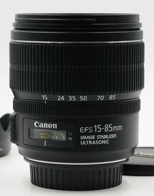

Thank you Mike!
I believe it is the 15-85 that has a mark on the zoom ring at the lower end of the zoom range. I finally figured out that this was the zoom position for the smallest travel and the mark was to indicate where to "park" the lens before you put it in the bag!
My 15-85 has no markings on the zoom ring. Are you thinking of another lens maybe?
Many of my other lenses have a mark on the zoom ring but it doesn't always denote the shortest length. I think it is just there because the spacing on the zoom scale markings don't match the travel on the zoom ring.
Mike Sowsun
It is the 17-85:
