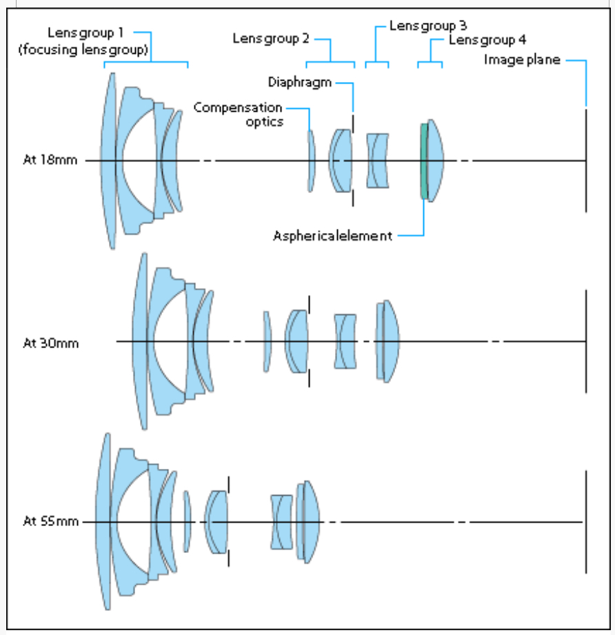

I am taking an online course on DSLR camera operation and someone posed a question about this lens. At 18 it's extended, at about 34 it's pulled in, but at 55 it's extended again. I see that my lens exhibits the same behavior. Why is this so? I've serach around and cannot find a picture or diagram of the inside of the lens.

This behaviour is very common with zoom lenses in the slightly wide to slightly telephoto category. It has to do with the way the internal lenses and groups move inside to change focal length using both retrofocus and telefocus lens design.
This diagram can give you an idea of the complexities involved.

A more in detailed answer is, not all lenses are designed with internal zoom, constant aperture, and internal focus. The most expensive and difficult designs to make. Different lenses are designed to do different specific tasks and to be produced at specific price points. Your kit lens the consideration was keeping the cost down. Period. In low cost designs the internal zoom elements might bump into other elements of the lens before they could travel far enough to extend, or contract, to the desired focal length. Compromises are done and room is made for the internals without worrying on what is happening to the outside.
