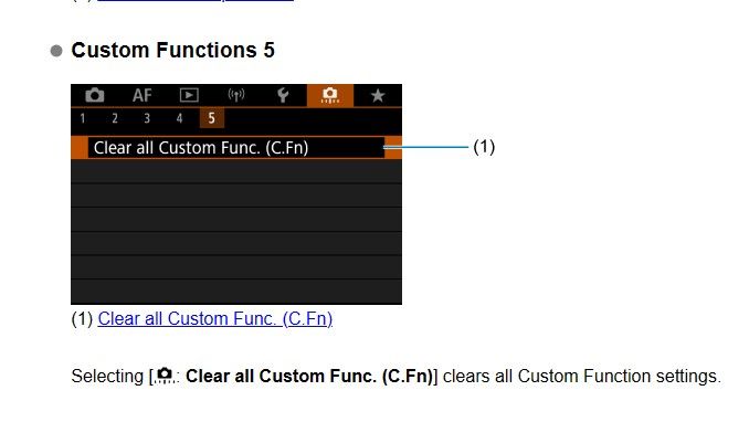

Check that the range switch on the lens is set to maximum range (1.2M-INF) and reset the camera and clear all custom functions. (There is no motor in the camera; focusing motor is in the lens.)
Screenshot 2023-04-08 133430.jpgScreenshot 2023-04-08 133430.jpgScreenshot 2023-04-08 133526.jpgScreenshot 2023-04-08 133526.jpg
