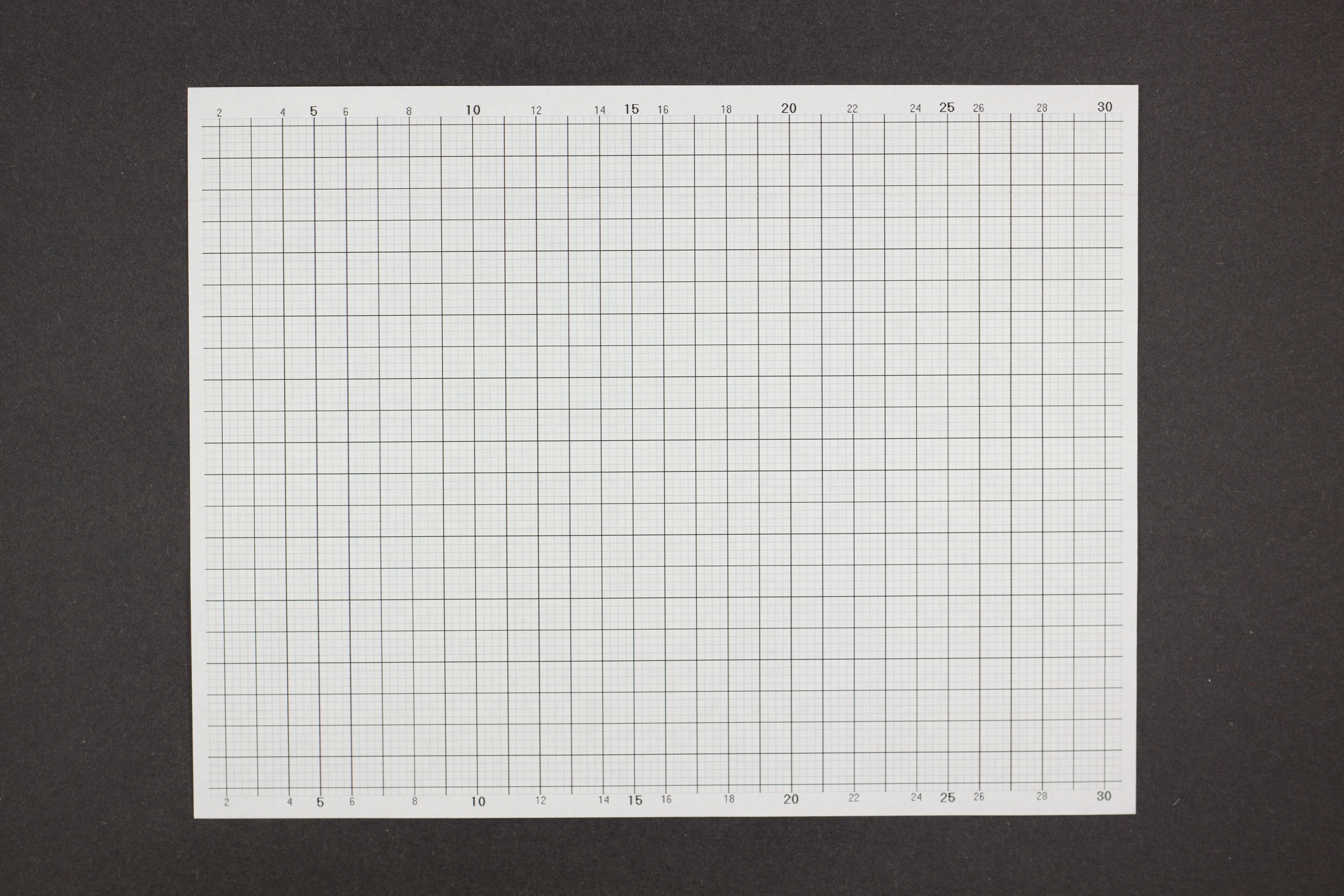

Here is a test shot done on a 7D with a 50mm. the bottom edge of the test page is where the sharpness problem is.

Here is a comparison of the corners from the previous image I posted, it is the size of a standard piece of copy paper . the test image was made from a capture done with a 50mm on a 7D. the test image was about 40" from the camera.
