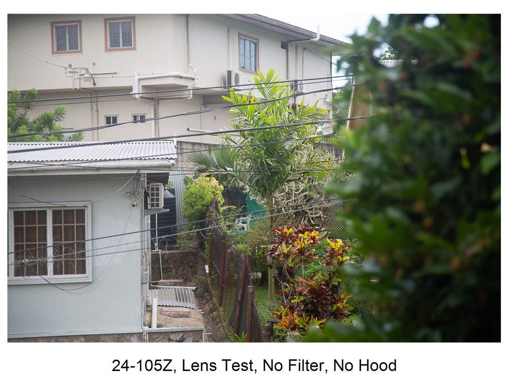

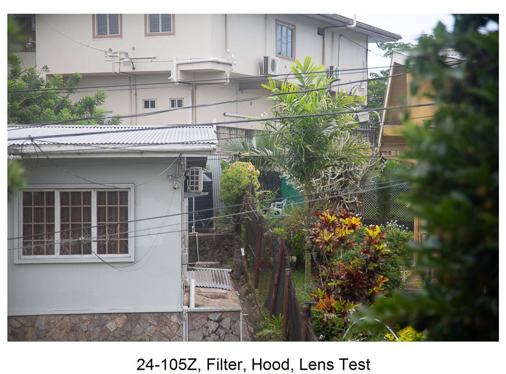

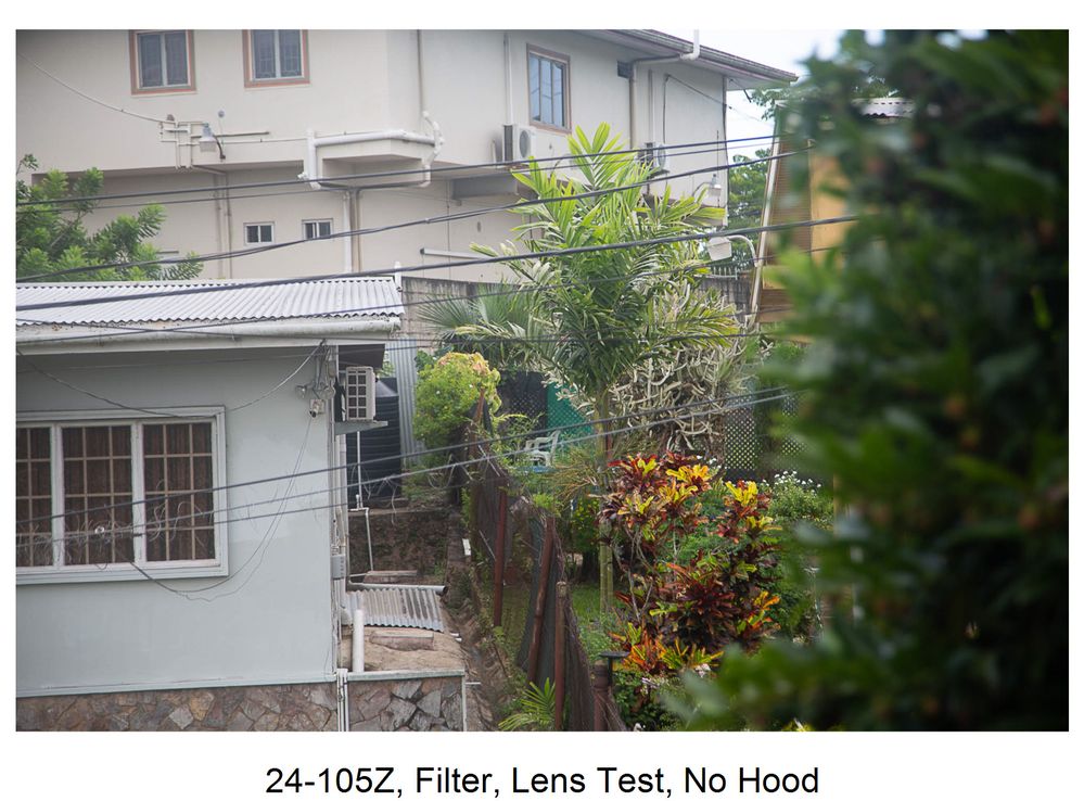

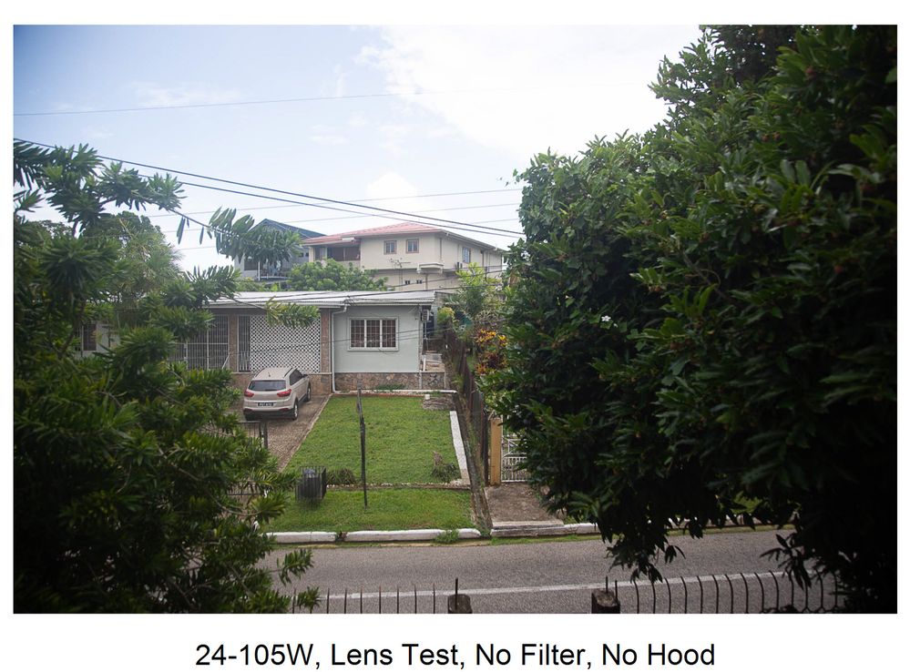

Hi - i did some trial shots - with the filter/hood on and off and with the same filter on my 70-200 for reference, both Wide and Zoomed.
First i made a mistake about the filter - its a simple UV filter like this one https://www.amazon.com/Hoya-Digital-Frame-Multi-Coated-Filter/dp/B002L60TTI?th=1
The photos were generated using Print from Lightroom because i can figure out no other way to put either the file name or other keywords on the photo - amazing that this cant be done in 2023. I ill appreciate any feedback - the Hooded + no Filter seems just slightly better. (Forgive the quality - trying to make the image small and i suspect that using "Print" also has issues)

I see a slight improvement without the filter. Is the front and rear element of the lens perfectly clean with no smudges or fingerprints?
07-18-2023 02:24 PM
Yes its all clean. The 70-200 is way cleaner and lacks any haze, all the 24-105's have this haze on it. The latter is wide open at 4, while the former is 2.8.
07-18-2023 02:28 PM
I explained why this became a problem in one of my other posts here. Im not blaming canon, I realized the problem with the repair too long after the repair. My question/post is fairly specific - its about testing a lens to see if there is an Axis or alignment problem. Sending it back to canon will mean at least 400$ + shipping and Duties when the camera enters back my country and i still might not fix it, and i dont consider this feasible at this point. Which is why i contemplated this.
07-18-2023 02:29 PM
With clean front and rear lens elements and no filter installed, there would appear to be some problem with the lens. I would recommend getting it serviced.
