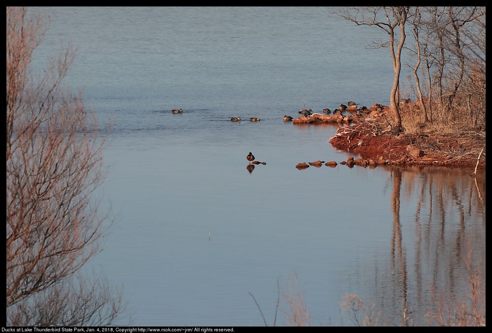

https://www.rsok.com/~jrm/2018Jan06_birds_and_cats/2018jan04_thunderbird_IMG_9888.html
Ducks at Lake Thunderbird State Park, Jan. 4, 2018, Oklahoma, USA
| Camera Model Name | Canon EOS 80D |
| F Number | 8.0 |
| ISO | 400 |
| Shutter Speed Value | 1/395 |
| Focal Length | 300.0 mm |
| Camera Temperature | 16 C |
| Focus Distance Upper | inf |
| Focus Distance Lower | 39.78 m |
| Lens ID | Canon EF 70-300mm f/4-5.6 IS II USM |
| Field Of View | 4.4 deg |
| Hyperfocal Distance | 581.96 m |
The F stop and focal length above are incorrect because a Vivitar 1.4X teleconverter was used to make the photo. The exif data was not corrected by this teleconverter. The actual focal length would be the length listed times 1.4.

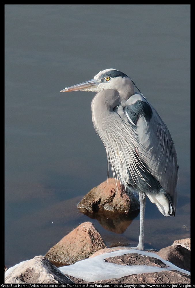

https://www.rsok.com/~jrm/2018Jan06_birds_and_cats/2018jan04_heron_IMG_9940c.html
Great Blue Heron (Ardea herodias) at Lake Thunderbird State Park, Jan. 4, 2018, Oklahoma, USA
| F Number | 7.1 |
| ISO | 800 |
| Camera Temperature | 20 C |
| Focus Distance Upper | 39.78 m |
| Focus Distance Lower | 19.39 m |
| Hyperfocal Distance | 655.73 m |
