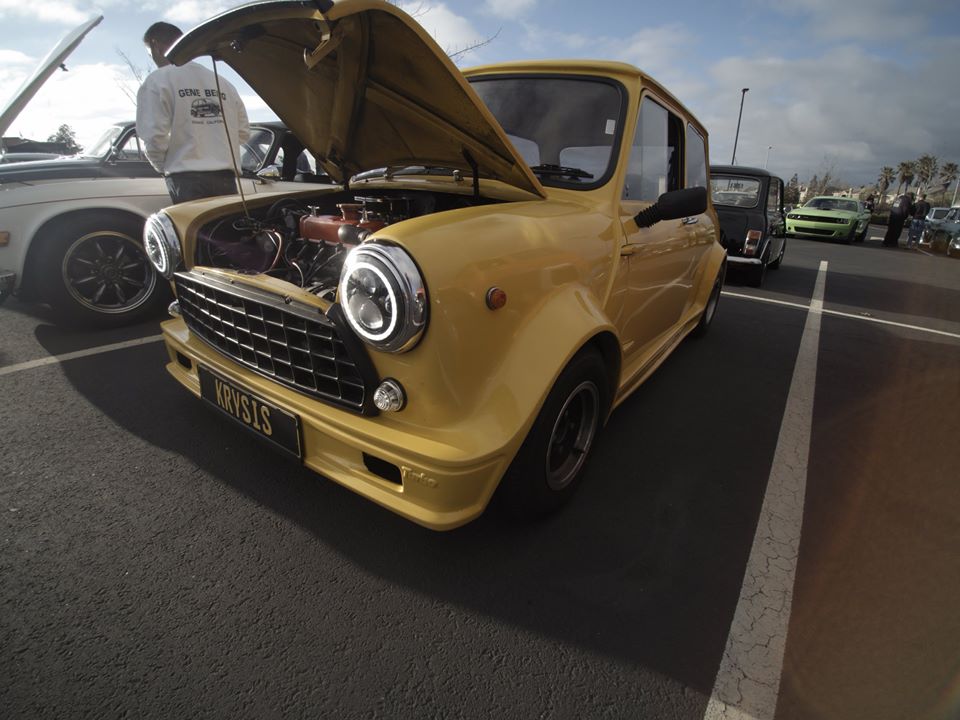

SacCarScene
16730103_1346493195411845_1565666960138646210_n.jpg16730103_1346493195411845_1565666960138646210_n.jpg16730561_1346492672078564_5208532708886491856_n.jpg
These were taken with the Canon EF-S 10-18mm f/4.5-5.6 IS STM Lens
