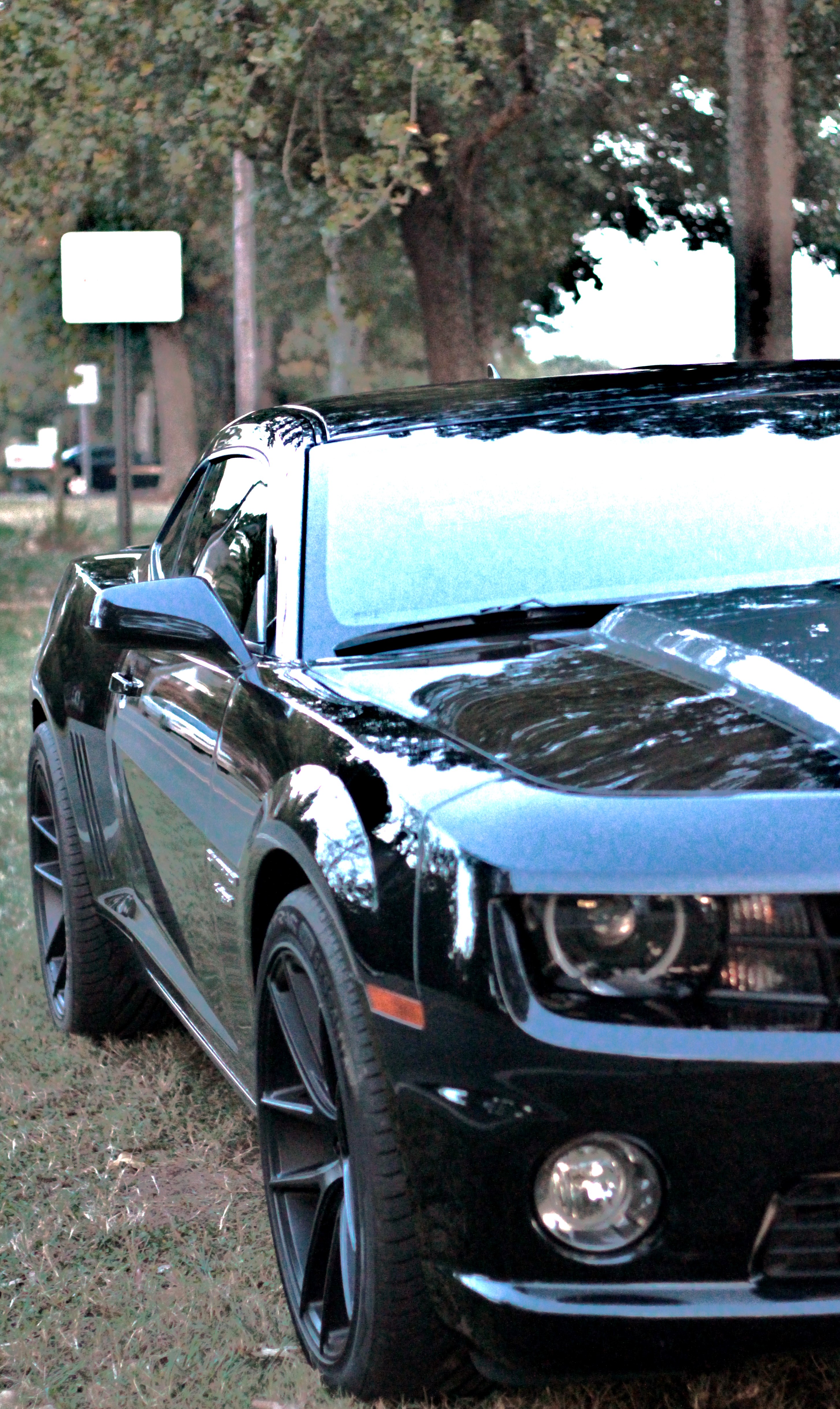

Thank you all..... I appreciate your advice and suggestions.
I have taken some pictures of my husbands Camaro....but didn't know if there was a better lens or suggestion.
I am currently using my kit lens.  But I worry my pictures can appear amateur

Your photos have way too much reflected "glare" which is a by product of the time of day, lighting, and angles you used. Although I'm not expecting you to get deep into this whole car photo shoot thing here's a thread about post processing car photos which should at least show you what people in general like to see. I don't think you'll have much control at that club event but it's going to be important that you understand what isn't desirable.

You can knock back the strong reflections by getting a "circular polarizer".  This is a round screw-on filter and they come in sizes... you need the size which matches the threads on your lens.  For example... the EF-S 18-55mm f/3.5-5.6 IS II has a 58mm thread diameter.
The polarizer rotates and if you look through the camera at something with a reflective surface (like a car windshield) while rotating the filter, you will notice the reflections getting stronger or weaker (depending on much you rotate it).  You want the car to have *some* reflections of course... but not so much that it's not possible to see through the glass.
Polarizers don't work well on ultra-wide lenses because the amount of light blocked also depends on the angle.  This means you end up with a "sweet spot" where the polarization works well... but at other angles it doesn't cut as much.  It will look fine on moderately wide angle lenses or anything narrower.
