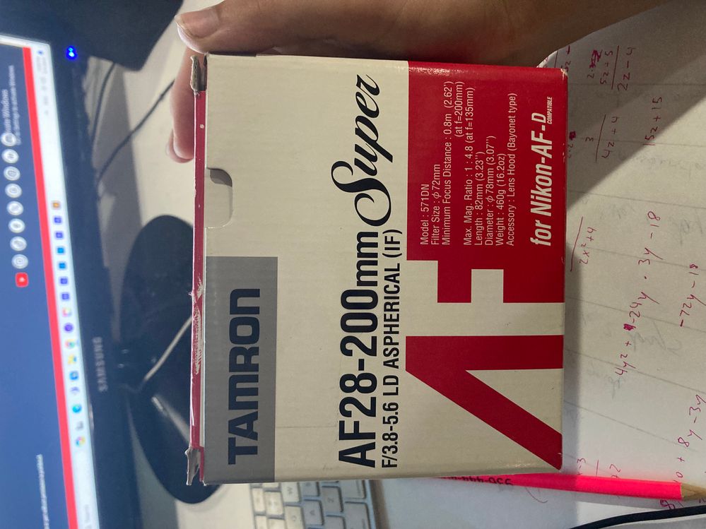

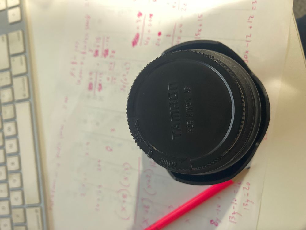

Hi guys,
I just found a Tamron AF28-200mm Super LD Aspherical Lens that uses the Nikon AF-D mount. This is apparently a super old mount and I'm having trouble finding clarity on how to adapt it to the canon ef-s mount that my rebel T3 uses. the back lens cap says "for nikon AF" so maybe it's not a D mount at all? I've never used nikon cameras, but it would be super cool to try out this vintage lens, so if anyone knows how to adapt it, I'd really appreciate it.

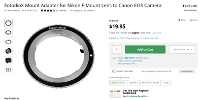

I'm not real familiar with the Nikon lens mount lettering system.  Is the AF mount the same as the F mount?  I'm guessing that it might just mean "automatic", but I honestly do not know.
That being said, Demetrius makes some very valid points.  If you are looking for auto focus, forget it.
However... if you don't mind using it as an all manual lens, you can find adaptors at B&H for as low as $20 for the Nikon F to Canon EF.  Here is one I found...
[Inserted Screenshot to facilitate conversation]
I have several old lenses from the film era that I use on my modern DSLR and Mirrorless bodies quite often.  They are a bit of work compared to an all automatic lens, but if you don't mind playing around with full manual lenses, some of these old lenses are really nice.  I use mine for mostly nature, landscapes, or architectural shots.  It's not something you really want for night time photography, people that are in motion, or wildlife.
