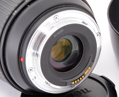

Sorry for the delay in posting, the holidays have been hectic. As an update after reading your posts I decided to give the lens a good cleaning, especially the baffle and electronic pins and I took some more test shots, they all came out fine, so the problem I was experiencing (the first shot I took only have a sliver of an image) is no longer happening.
Here are some shots of the rear element of the lens, I was focusing on trying to show the protrusion so the quality is not super, and of course the lens I was shooting is the one I would use to take such a shot..

Looks like a normal EF mount to me.
