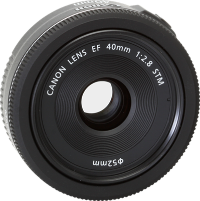

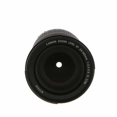

Actually Canon makes 3 full frame EF lenses. The EF 40mm F/2.8 STM, EF 50mm F/1.8 STM and the Canon EF 24-105mm F/3.5-5.6 IS STM Lenses.

12-29-2022 01:18 PM - edited 12-29-2022 01:55 PM
Actually that is Not true Canon has made 3 EF (Full Frame) STM lenses. The EF 40mm F/2.8 STM, EF 50mm F/1.8 STM and the EF 24-105mm F/3.5-5.6 IS STM. Canon does make Nano USM lenses which are focus by wire.

12-29-2022 02:53 PM
Hi,
We're both correct.
You're using past tense, while I used present tense in my earlier response.
In total, Canon has made three full frame EF lenses with STM.
But they've discontinued the 40mm and the 24-105mm,...
So presently there is only one: the EF 50mm f/1.8 STM.
