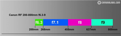

Also, when you look at the cost in terms of light transmission efficiency, the RF 200-800 comes out faster by a stop over the EF 100-400 (as per the image below, at 560mm the RF 200-800 shoots at f/8). Here are the comparative specs:
So, in summary... If you want a focal range of 200-800, don't buy a teleconverter, get the right lens for the job. It's a more efficient configuration and, in the long term, the better investment.
