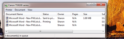

My print que will not clear after a print job is completed. The que shows printing and shows the correct printer but when printing is complete the print que is still active and will reprint documents forever unless cleared manually.

Have tried support and downloaded other fixes suggested by support. No answers on this issue. Too bad it is a lovely
printer but never expected to have to waste my time geting print jobs to print.
Spooler just fills up. I clear it manually but you can only print one job and second job just keeps spooling , not printing. Everything just freezes.

FYI Canon does thorw out an error message from the utility program for the printer that the printer is not responding> But the printer does go ahead and print.
This seems to send the spooler over the edge.
