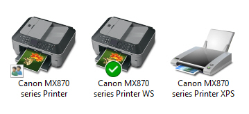

MX 870 is not printing after upgrade to Windows 10. Uninstalled and reinstalled all the drivers and tried wired and wireless conections. Reviewed settings on printer. Canon Network Tool will see the printer on the network but canot connect with it.

Hi! Yes, the MP driver installs without error messages:
Setup Results
Model :
Canon MX870 series
Network Setup of the Printer :
Completed
Name :
Canon MX870 series Printer (Copy 1)
Port Name :
CNBJNP_001E8FEF7D9C
Network Setup of the Scanner :
Completed
Name :
Canon MX870 series(00.1E.8F.EF.7D.9C)
Network Setup of the Fax :
Completed
Name :
Canon MX870 series FAX (Copy 1)
Port Name :
CNBJNPFAX_001E8FEF7D9C
It wil not then print a test page, the status of the print job is blank after several minutes.

I now have three printer drivers installed and the WS will print, though printer not connected error appears and it takes much longer for the file to spool. Better than no printer at all.
