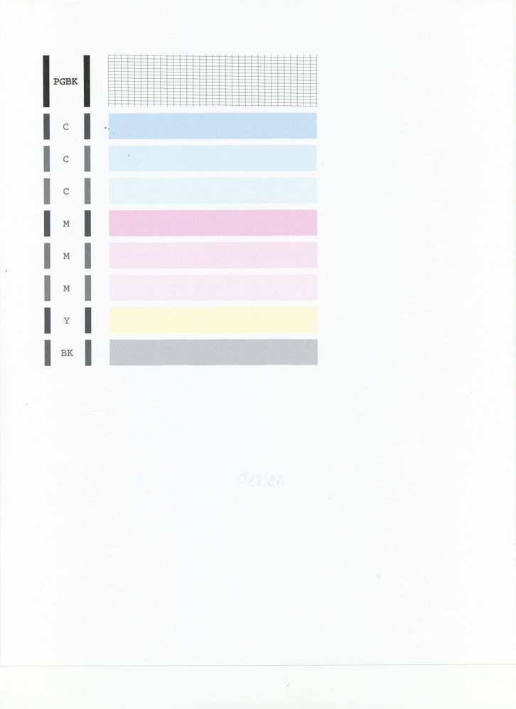

Hi kl141,
First, please perform a test of your printer. To do this, please follow these steps:
1. Please press the MENU button on your PIXMA MX922
2. Use the down arrow key until the wrench and screwdriver icon is selected, then press OK
3. On Maintenance, press the OK button
4. Select Print nozzle check pattern and then press OK
S. Select Yes and then press the OK button
A test page will print. Please compare your printout with the example below.
Does your nozzle check print correctly?
If not, please make sure that each ink tank contains ink.
Next, please perform a few printhead cleanings:
3. Select Maintenance then press OK
4. Select Cleaning and press OK
5. Select Yes and press OK
After performing 2 or 3 cleanings, please print another nozzle check.
