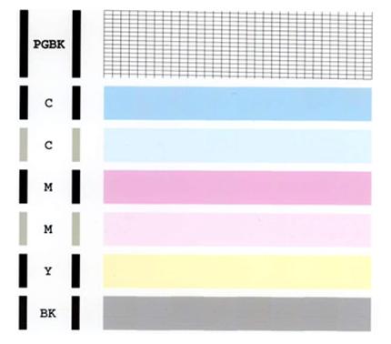

Next, a test of the printer should be performed. The Nozzle Check pattern shows if each print head nozzle is operating properly. Please perform the following steps to print a Nozzle Check pattern:
1. Turn the printer on and make sure paper is loaded into the sheet feeder.
2. On your printer, press and hold the RESUME button until the printer light blinks twice. When you release the button, the Nozzle Check pattern will be printed.
3. After the Nozzle Check pattern is printed, compare the results to he example that has been attached to the bottom of this post.
4. If any colors are missing or if any horizontal lines appear in the color bars, perform the print head cleaning procedure.

Once you have completed two cleanings, please perform another Nozzle Test. If colors are still missing, turn off the printer. After 24 hours, turn the printer on and perform one more cleaning. Once the cleaning is complete, print another Nozzle Test.
