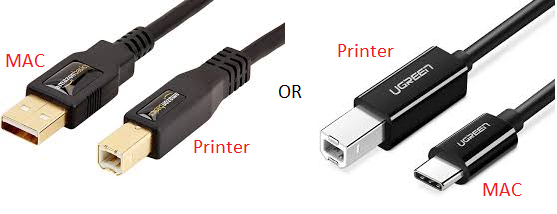

You've told us you have a MacBook runing BigSur
You haven't told us the model or age, so.... these are your options:
You would chose the one that fits your situation. Standard USB (Left) or USB-C (Right)
As stated previously, there are no drivers for BigSur. So there is no guarantee connecting the printer using a cable will work.
I suggested trying over wireless which offers greater chance for success and will also give you greater flexibility printing since you can print from other network devices (supported computers, mobile devices, iPADs, etc)
This suggestion also doesn't require sourcing/buying a cable. I believed this would be helpful.
