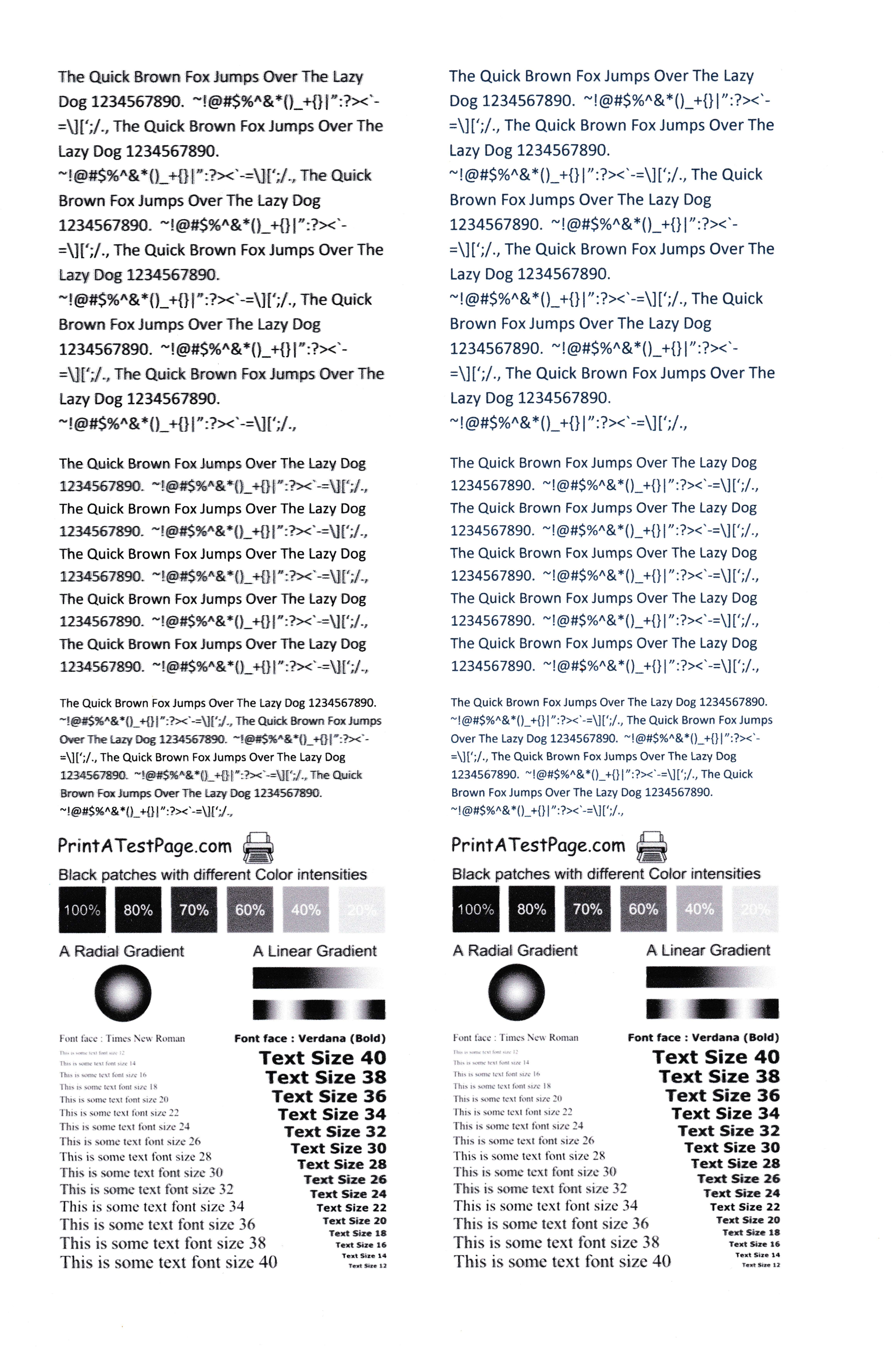

Hi All,
I've put together a Test Page to demonstrate the problem. Both columns in the Test Page are identical. The only difference is that the text on the left hand side is Black, whereas the text on the right hand side is Dark Blue.
The graphics are identical on both sides and are Black.
You can clearly see that even when printed on the same page, the black text is treated differently. The black text in the left hand column exhibits the error, with various lines appearing sharper or more blurry than others.
The text on the right hand column is uniformly sharp and prints correctly.
Note that the text objects in the graphics on both sides is blurry, but any graphically printed objects are sharp.
Also note that the black text in the left hand column should appear identical in thickness and sharpness as the text in the right hand column.
This test clearly shows it's not a mechanical error with the printer (as both sides would exhibit the same fault), but potentially either a print head problem associated only with the black text inkjets, or a software problem. Either way, you can see it shouldn't be happening.
Canon - you have been deadly silent on this issue 😞 Comments?
