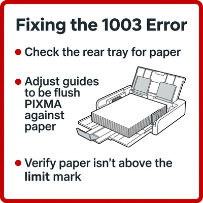

My canon PIXMA TS6320 was shows an error 1003 code how to fix it

An error 1003 on your PIXMA TS6320 typically indicates that the printer is out of paper or that the paper is not feeding correctly from the tray. Please try the following steps to resolve this:
Ensure the paper is loaded correctly in the rear tray and that the paper guides are adjusted snugly against the edge of the stack. Make sure the paper feed slot cover is closed properly. If the printer is still not detecting the paper, try fanning the stack of paper to ensure the sheets aren't sticking together before reloading. If you continue to see the error after checking these, please feel free to reach out to our support team directly at https://canon.us/account so we can look into this further.
