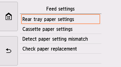

2. Tap the gear icon at the bottom of your printer's display.
3. Tap Feed settings.

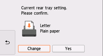

4. Tap Rear tray paper settings.

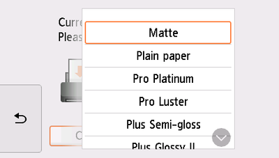

5. Tap Change.
6. Select KG/4"x6"(10x15) from the list.
7. Select Matte.
8. Tap Yes.
Once set, when you attempt to print with letter sized plain paper, the printer will use the cassette to feed paper.
