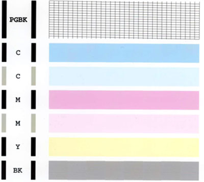

Next, a test of the printer should be performed. The Nozzle Check pattern shows if each print head nozzle is operating properly. Please perform the following steps to print a Nozzle Check pattern:
1. Load letter-sized plain paper in the auto sheet feeder.
2. Press the <FAX> button.
3. Press the <MENU> button.
4. Press the right arrow to select Maintenance / Settings, then press <OK>.
5. Press <OK> to select Maintenance.
6. Press <OK> to select Nozzle check.
7. Press <OK> to select Yes.
The nozzle check pattern will now print. Please compare your printout with the example at the bottom of this post. If the page prints blank, or there is missing lines or streaks, printhead cleanings should be performed.
