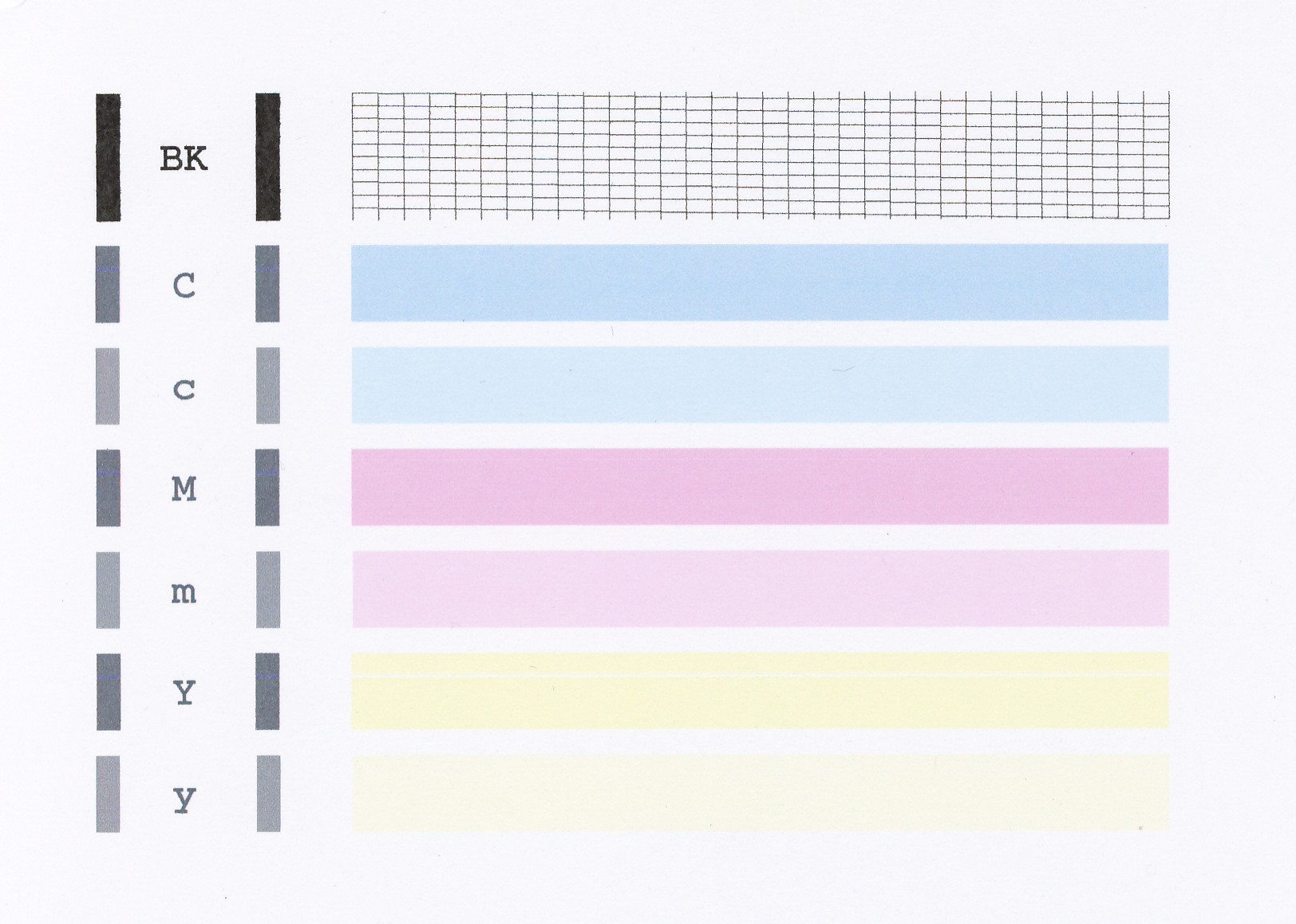

First, a test should be performed of your printer.  The Nozzle Check pattern shows if each print head nozzle is operating properly.  Please perform the following steps to print a Nozzle Check pattern:
 1.  Press the OPEN button to open the Output Tray.
 2.  Load letter-sized, plain paper in the Auto Sheet Feeder or the Cassette Tray.
 3.  Press the COPY button.
 4.  Press the MENU button repeatedly until 4.MAINTENANCE is displayed in the LCD.
 5.  Press the LEFT or RIGHT ARROW buttons until NOZZLE CHECK is displayed in the LCD, and then press OK.  The nozzle check pattern is printed.  Please compare your printout to the example that has been attached to the bottom of this post.
Does your test page print correctly?
