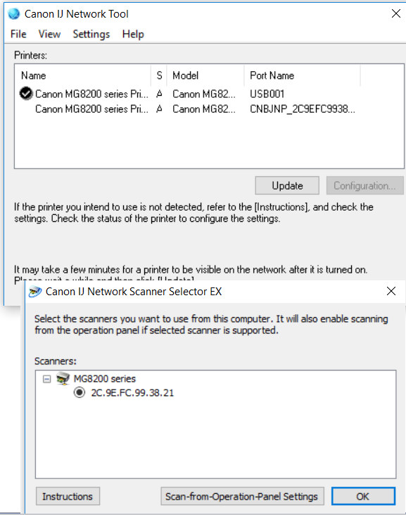

Hi and thanks for the answer. Everything is as checked. But I noticed that there are 2 printers on the network tool. The second printer listed says "copy1). I tried to set the second as my printer but cannot. The reason I tried to set it is because on the SCANNER selector tool the port name is the same as the printer. Take a look please.
So leaving everything as it is currently, now when I try to scan from the MG8220 the panel reads set the pc to start scanning. I click on scan from operations panel, but nothing scans.
Thanks in advance for the help.
05-04-2016 10:04 AM
Hi Smiseel,
In the Canon IJ Network Tool, currently the USB connection is selected. Please select the second one down, the entry that lists CNBJNP_2C9EFC9938... as its port. Once selected, you should then be able to scan.
