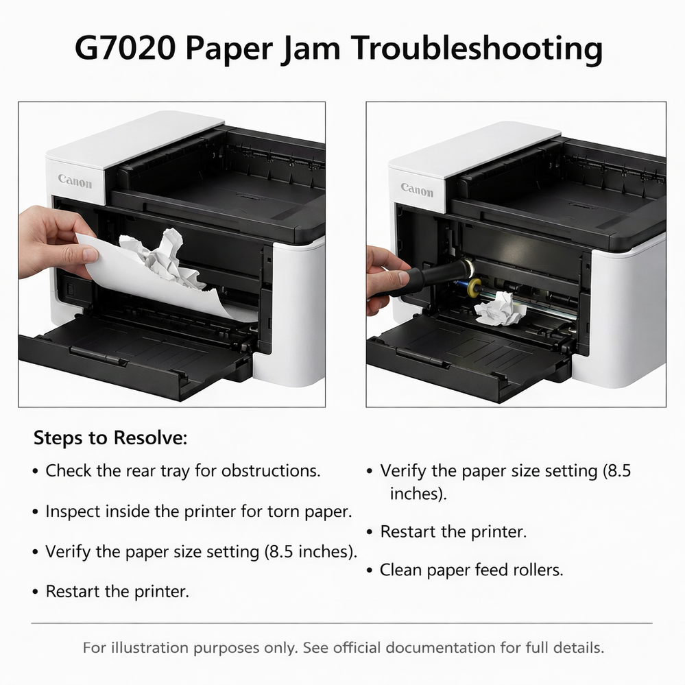

We understand you're having trouble with your G7020 paper tray and the Error 1300 message. This error typically indicates a paper jam. Here's a step-by-step guide to help you resolve this issue:
  1. Check the Rear Tray: Make sure there are no obstructions or jammed paper in the rear tray. Remove all paper and inspect the tray thoroughly.
  2. Inspect Inside the Printer: Open the printer and carefully check for any torn pieces of paper or obstructions inside. Use a flashlight to get a better view.
  3. Paper Size Setting: Ensure the paper size is correctly set to 8.5 inches as you mentioned. Sometimes, even if it's set correctly, re-adjusting it can help.
  4. Restart the Printer: Turn off the printer, wait a few minutes, and then turn it back on. This can sometimes reset the system and clear the error.
  5. Clean the Paper Feed Rollers: Use a soft, lint-free cloth to gently clean the paper feed rollers inside the printer.
If the issue persists after following these steps, please visit our support page for more detailed troubleshooting or contact our support team directly: 800-OK-CANON (800-652-2666) or https://canon.us/account
Thanks - it worked. I had cleared a jam just before, but I heard he rollers spinning and it must sucked another sheet in.
