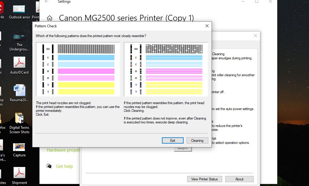

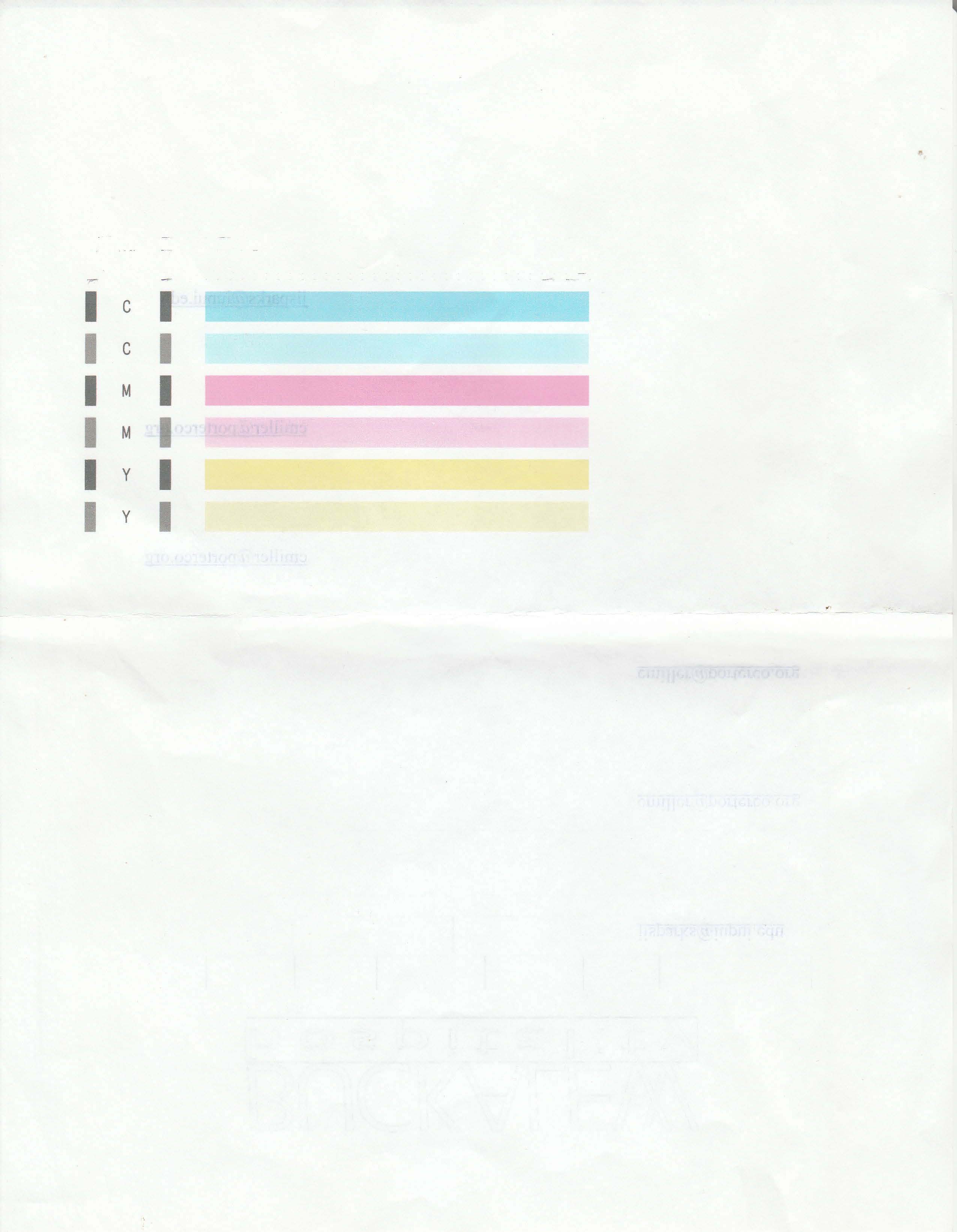

I have printed to "Print Head Alignment" pattern during installation. I does not print the arrow in the upper left corner of the printout. I does print colored columns in a certain pattern (see attached)
The printer is connected via USB
The printer was purchased Nov 2014
Here is the nozzle check pattern
Here is the Guide Pattern from the menu
I appears that I may have a clogged nozzle for the black ink. What do you think? Does mean JUST REPLACE THE PRINTER?
