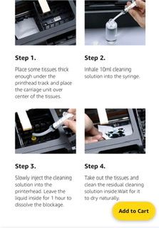

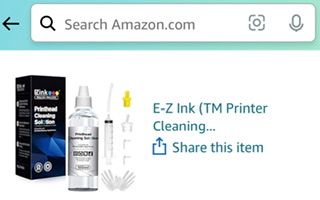

I just ordered a cleaning kit on Amazon that says it's for Canon & other inkjets for $7 & it had these 4 pictures showing how to do it. Wish me luck! 😉
12-23-2023 12:08 AM - edited 12-23-2023 12:09 AM
You got it! You won't need luck - it's a straightforward job. Just in the picture in step 3, you may have to press the attachment to the nozzle, otherwise the liquid can squirt sideways or the cap can come off under pressure.
Be sure to soak the entire print head in the cleaning solution for 2-4 hours first. Alternatively, you can use rubbing alcohol (70%), or just hot water (white it's hot).
12-28-2023 04:55 PM - edited 12-29-2023 12:29 AM

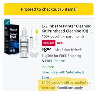

TOO COOL! I got an ink jet cleaning kit on Amazon for $8.02 and it fixed it first time. 15 minutes soaking & then putting it back together and running the Clean Jets program in the printer at Menu > Maintenance (or something like that). I just had to play with things to figure out how to get some toilet paper under the PGBK spot with the cartridge rack moved to the center with the power cord turned OFF. I think the kit was supposed to come with rags but it didn't, so I just used a few sheets of TP folded in half.
The syringe works great but I probably used more than the 1ml it said to. I had the syringe full to 1ml + the tube below it that I'd sucked it up with. Probably supposed to pour it in since then there wouldn't be extra in the outlet tube, but that seemed awkward so I sucked it in.
There's LOTS more cleaning fluid left in the jug, a lifetime supply. 😉
The kit says it's for several brands and models. E-Z Ink (TM Printer Cleaning Kit for HP / Epson / Canon / Brother Inkjet Printers. It's got 100ml of Cleaner, so I'll never use it all.
Here's the Amazon link:
