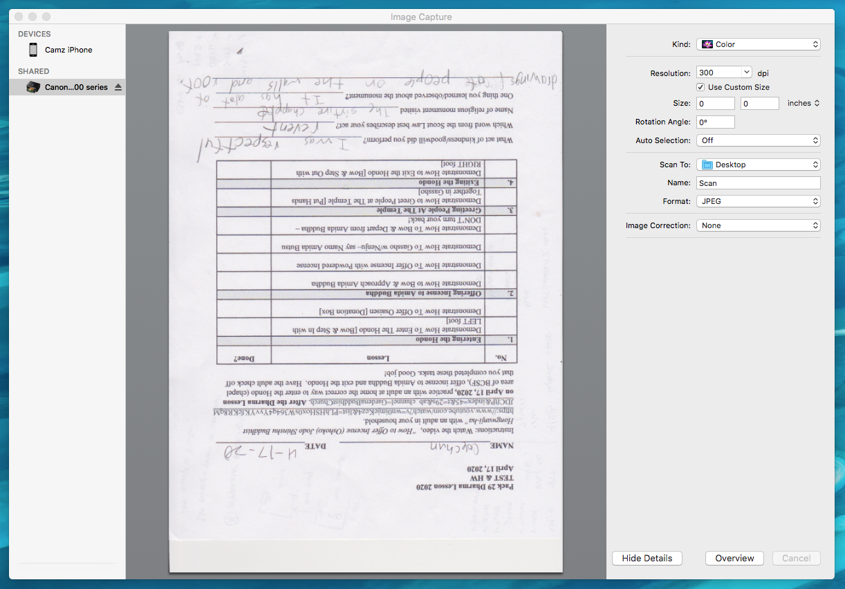

My scanner has stopped working on my Mac. The device is connected wirelessly. First, I reinstalled the IJScanner driver but that did not do anything. Then I found a posting in the community that instructed to try to scan through Image Capture. When I did that, Image Capture recognized the Canon device and scanned the image. There is a preview on my screen, but I can't see a way on the Image Capture software or the Canon device to save the scan. I've attached a screenshot of Image Capture. Any advice on either how to save the scan or how to get the IJScanning software working again? Thank you.

Hi ikedachun721,
In the Image Capture window you can click on overview to get a preview of what is on the glass. After the preview appears you will need to drag you mouse over the preview image on the left to select the part of the scan that you want. Once it has been selected, the option for scan will appear in the bottom right. Once you click scan it will scan the item on the glass and save it to whatever you have selected in the scan to drop down box in that window.
