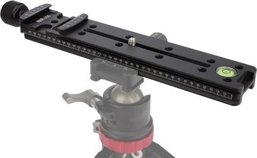

Perhaps a sliding mount like this to still use what you have. You can shift the center of balance. Plus they are not expensive
