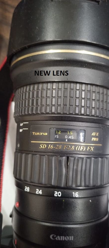

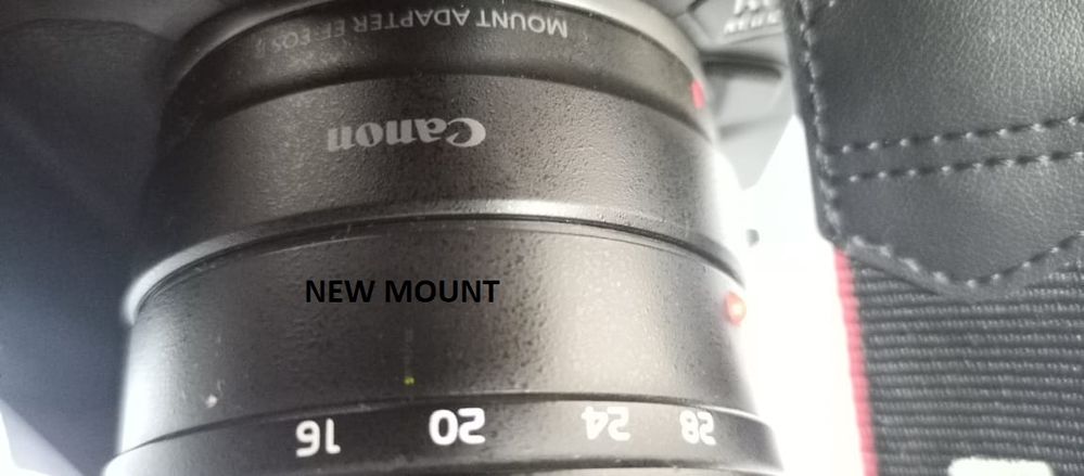

Please note the series of photos. Before photo, the new mount and the old lens with ner camera photo.
WhatsApp Image 2024-08-26 at 08.32.47_42d849a9.jpgWhatsApp Image 2024-08-26 at 08.33.54_9db1220b.jpgWhatsApp Image 2024-08-26 at 08.33.36_36694ab3.jpgWhatsApp Image 2024-08-26 at 08.29.46_3aa149d6.jpg
I don’t see any rings in your sample.
please note the four corners of the image and how there is kind of a BRIGHT ring around it
can you tell the brightness on four sides of the photo
