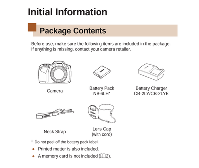

Thats the battery listed on the support portal for the SX530.
Its out of stock on Canon USA. In Stock at B&H
Canon NB-6LH Lithium-Ion Battery Pack (3.7V, 1,060mAh) 8724B001 (bhphotovideo.com)
Not sure where you are located, but if you have a SX530, that is the battery Canon lists as compatible.
Downloads for your device are here:
Canon Support for PowerShot SX530 HS | Canon U.S.A., Inc.
Manual:
pssx530hs-cu2-en.pdf (c-wss.com)

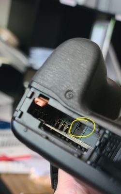

Can you show us a picture of the battery compartment?

Failing that, if you can take a photo (with a call phone for example) of the battery compartment interior while checking there is not damage to it that might stop a batter from being inserted.

We have tried to insert the battery in other ways, yes. It goes in only one way, and it sticks up just slightly and is very difficult to get in and out. On inspection with a strong light, there seems to be a spring? A crook of bent wire in the bottom of the battery compartment. Maybe it should flatten when the battery goes in??
10-10-2024 03:21 PM
Yes it should, I believe that is what pushes the battery out when you slide the catch out of the way so you can grab it with your fingers.
