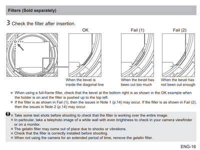

The RF 10-20 has a built in gel holder.  Only one I'm aware of currently.  There may be others?? (but I don't recall seeing any).
