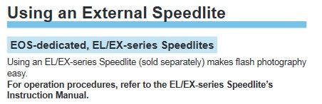

Any Canon EX or EL series speedlite is compatible with your camera. IE the Canon 430EX II, 580EX II, EL-100 and EL-1 are compatible with your camera. Note older speedlites released prior to the 430EX II and 580EX II. IE 380EX, 430EX and 580EX are not compatible with the speedlite control menu. All settings with these older speedlites must be changed on the speedlite itself. Canon cameras released from 2007-Present support the speedlite control menu.
