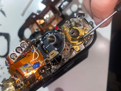

Yes, this is an old camera. Either way, I have an A2 power winder (which I know is working), and it will not wind on my A-1. I am not opposed to taking it apart to find the problem, I just have no idea where to start. The camera works and has charge, it’s just that the winder is not getting the signal when the shutter is pressed. Some help would be appreciated!

Ok, solved it. Inside the camera, there are pins above the winder that have contact with gold plates. One was bent, not allowing current to flow when the shutter is fired. Pics are attached. If anyone has any power issues with on and off, power winder or timer issues, this area is the place to check.

So just to clear some stuff up, my friend has an a1. She has a different auto winder, and it works on hers. My winder works on her camera as well. Neither work on my a1. Must be an electrical issue inside the camera somewhere, and I’m sure it probably isn’t an easy fix. I swapped camera batteries, changes nothing. Very interesting issue. There isn’t any corrosion visible when I take off the bottom plate. If anyone knows anything, lmk. Not the end of the world since the camera is fully operational otherwise, I just want to use the winder.
