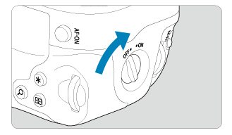

I have the BG-R10 battery grip for my R6 and recently it keeps shutting down after a couple pictures are taken and the red light to right of set wheel comes on. I have determined that it only does this when the battery grip is on the camera, other wise I don't have the issue. I have tried looking for firmware update and have found nothing and I have found no youtube videos on fixing the issue. Any one have any pointers or ideas?

Are you turning the v-grip on / off switch to off when the grip is not in use?

I am using Canon Brand LP-E6NH batteries. Yes I have been able to take off the grip and put a battery in the camera and it works and has a full charge. And No the switch is not on when not being used vertically.
