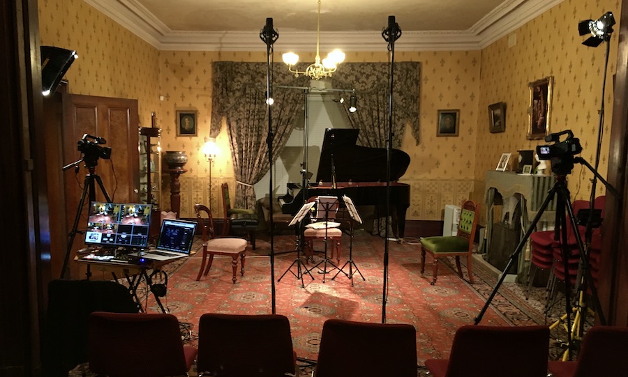

For live streaming I use the Blackmagic ATEM Mini Pro & a Mackie audio mixer in a custom made fold up rig.
These stills are from footage shot using the "Normal" video profile.
