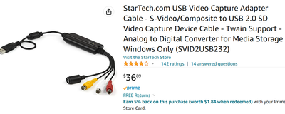

I'm trying to move video files to my pc using one of the USB RCA devices off Amazon. I had a ZR10 when recording the video back many years ago, how ever the eject decided to not work. I went and purchased a working device off of Ebay and for the life of me cannot figure out why I can't get the video to show up on my PC screen. I get audio which is horrible, but the video isn't showing at all.
I do have both in perfect condition on the camcorder itself. Is there a button on the remote I have to press to get video to play out? Should I try the S-Video cable instead of RCA?
Would appreciate any support.
