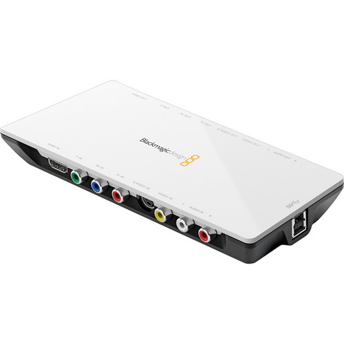

More than likely your laptop does not have a FireWire port so to connect the camcorder to your laptop you will need a video capture device. One example is the Blackmagic Design Intensity Shuttle.

It's really not as complex as it sounds. With the right capture device you should be able to easily capture the tapes to a computer and then convert them into any format you desire and store them on whatever medium you like.
I suggest you look for videos on how to make the connection to the computer via a video capture device as that may make it easier to understand.
