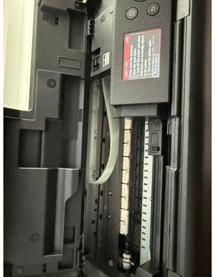

I recently moved to Israel and transported my Pro-300. Since arriving, I consistently get error 5100. The recommended clearing steps do not work. I do not see any obstruction in the device. However, when the printer is turned on, the ink carriage does not move to the center as it did before I moved. The power light is flashing.
Recommendation for path forward? Thanks.

After receiving the above response to my query, I looked at the printer again and can report that it simply does not look right. I'm attaching a photo showing the internal of the printer with an odd appearing thick grey belt and the information block (external)brian's imagepro-300
Please review and let me know what you think is the solution. If it needs to go to a dealer for repair, can you please direct me to a Canon service support center in Israel (preferably in the Tel Aviv area).
