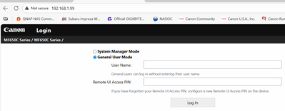

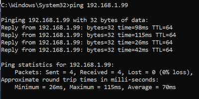

In the below examples, the IP address of my printer is 192.168.1.99.
To confirm, when you ping the IP address of the printer from a command prompt you get replies?
When you enter the IP address of the printer in a web browser, what displays?
You should see both.
