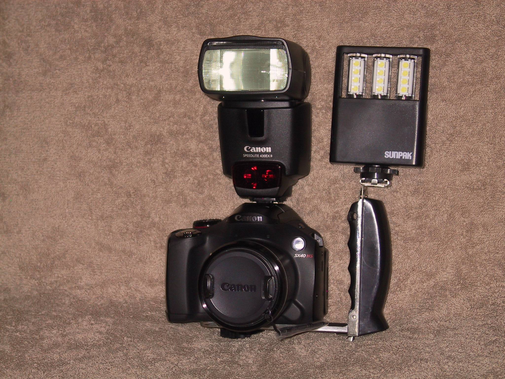

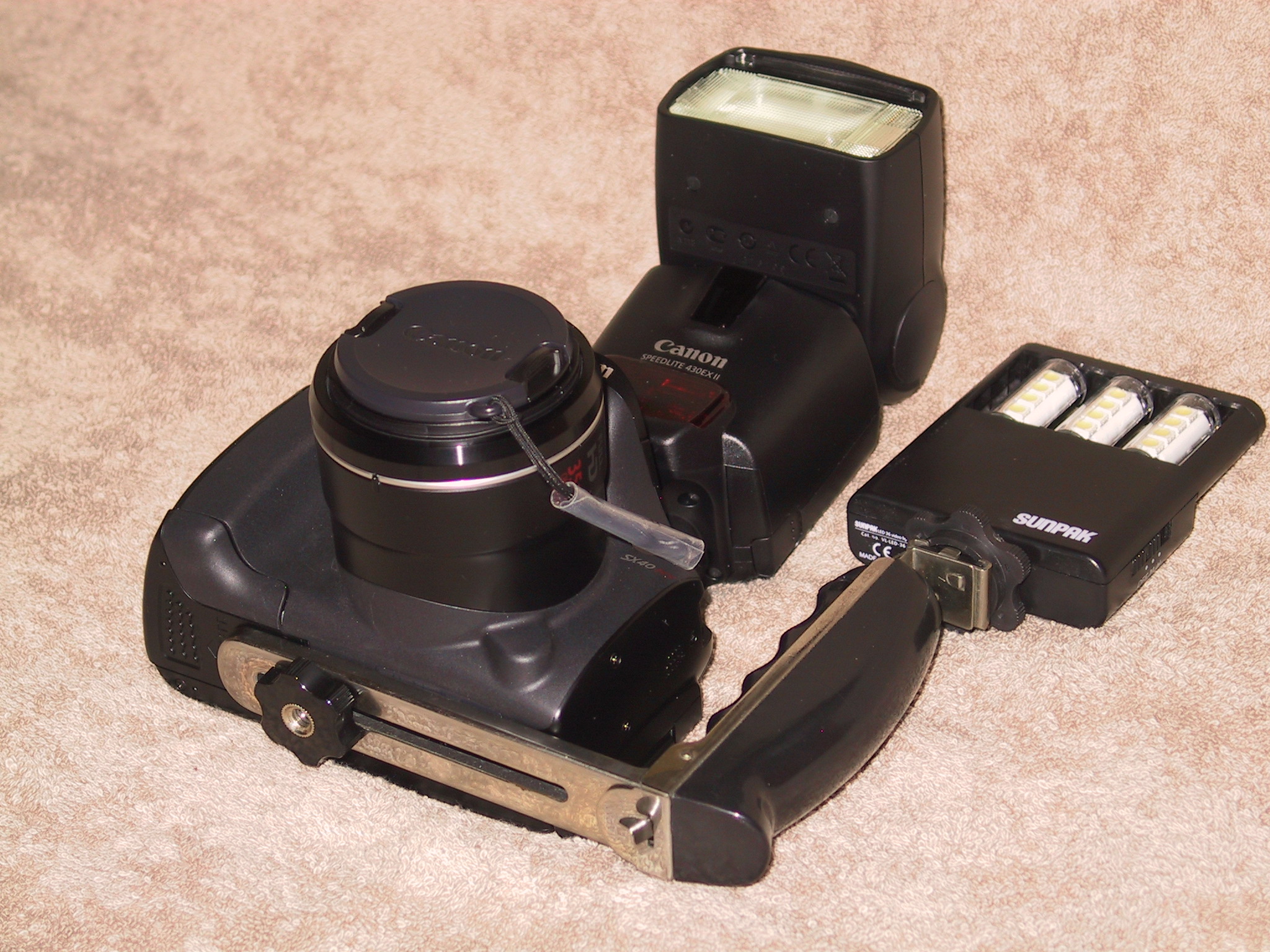

My ultimate solution to AF Assist with ultra-long zoom lenses in low light conditions:
